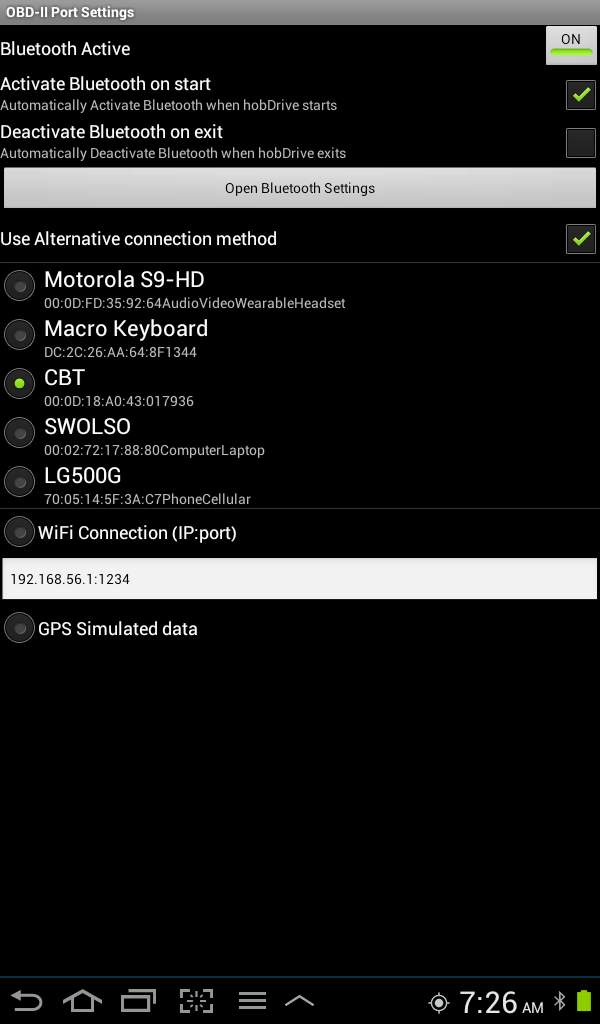

Here ia a screenshot of my settings screen. I don't see any other method of connection except the one i am using (CBT on Bluetooth)
Re: Hobdrive on Android Beta
Stephen, you should update to 1.1.50 version - it contains an extra "android4" method.

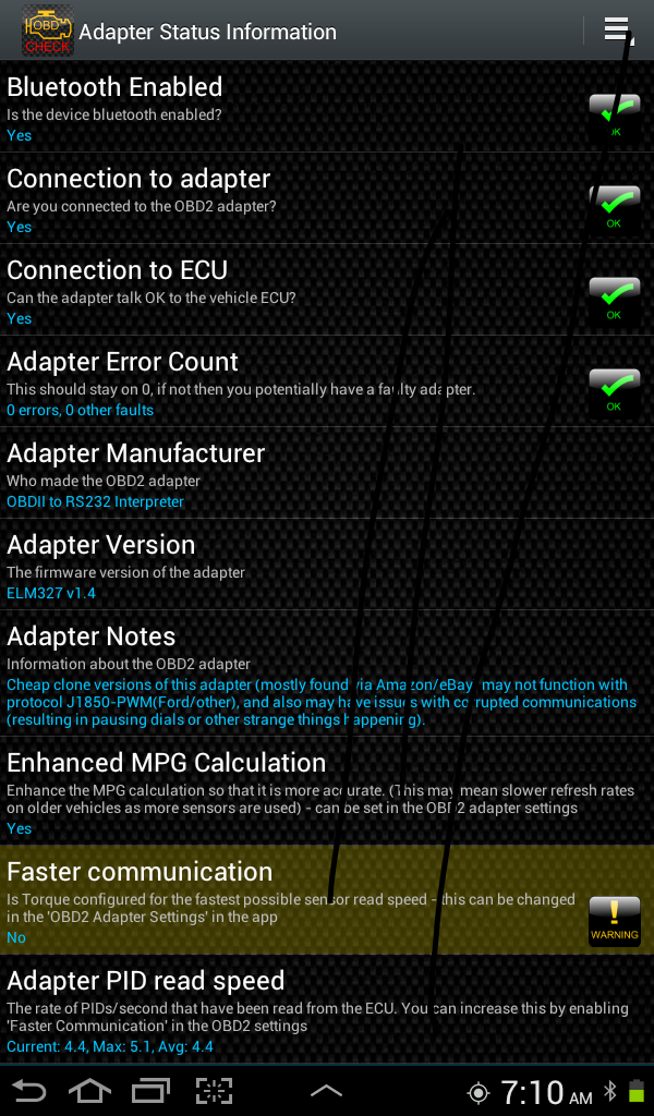

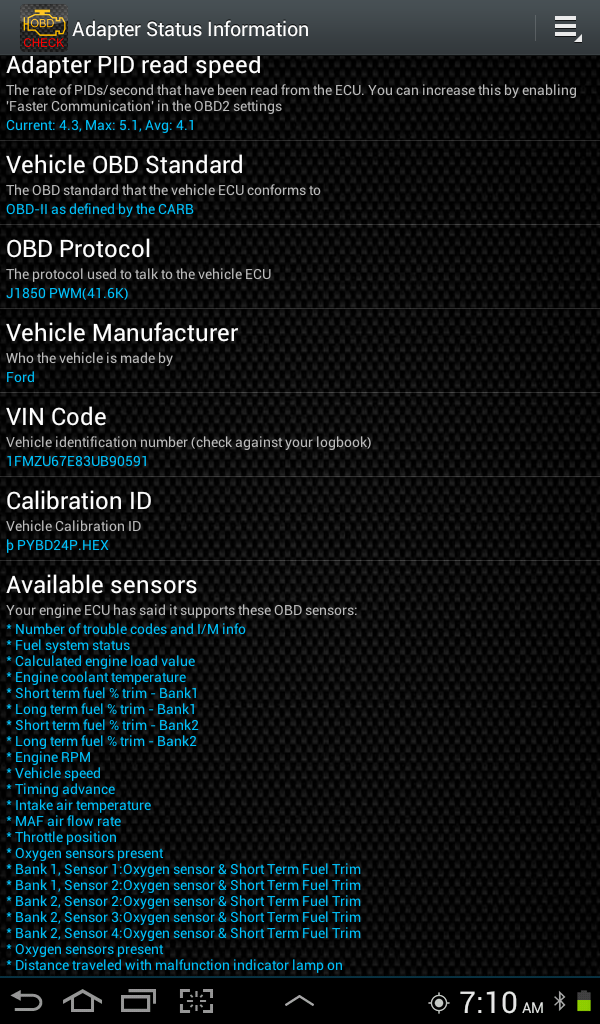

With Android 4 picked, I get no connection at all, with jni picked, the tablet locked up and would not respond even to the power button. On automatic, I did get 10 seconds of connection again.
I will attach log file and screenshots from Torque Adapter Info (for reference).
One thing I thought about this morning. I have a Supertuner XCAL flashed tune in my ECU (aftermarket program for towing a large boat). Do you think that is causing an issue? It never affected HOBDrive in Windows Mobile.
