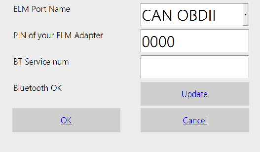

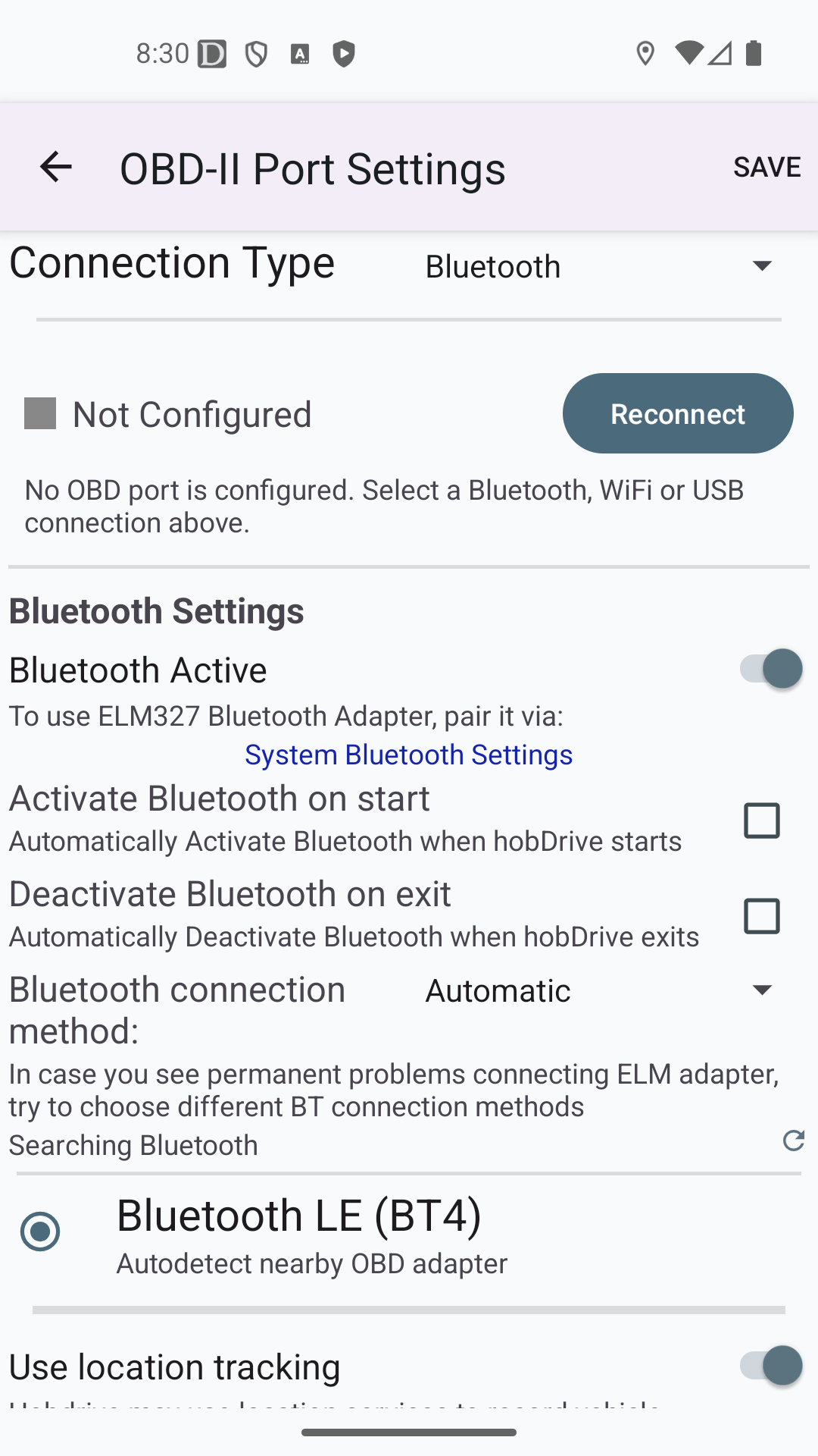

1. Connect the ELM327 Adapter
Open: Screens -> Settings -> ELM Connection Parameters.
Connection options:
More about adapter quality and compatibility: Problematic ELM327 adapters.

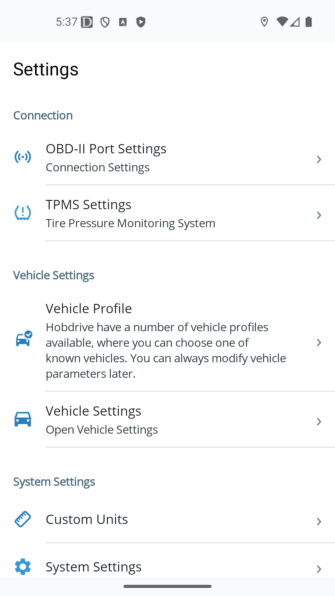

Settings Screen
Key sections:

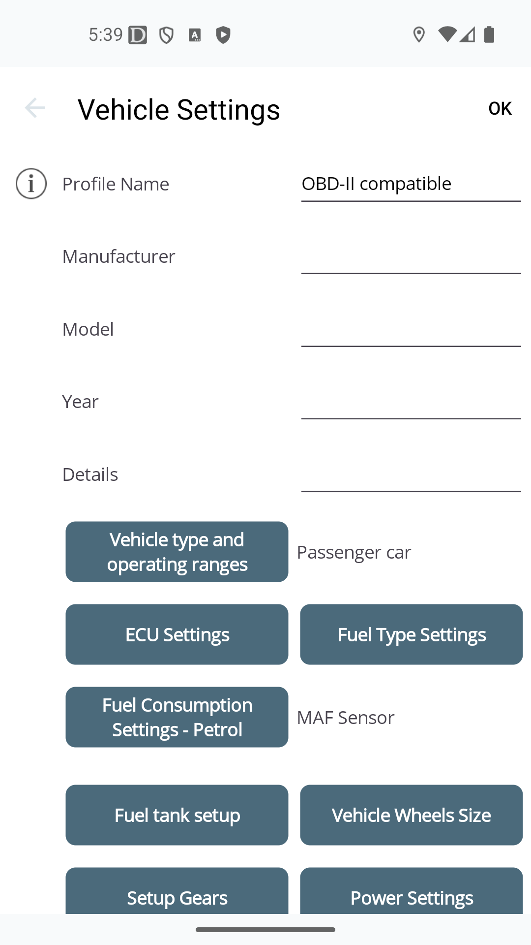

Vehicle Parameters
On this screen you can configure your vehicle type and connection parameters. For starters, if a ready-made profile exists for your model (“Load from Template”), use it. Only try manual configuration if no template is available.
Detailed article on profiles and templates: Ready-made vehicle profiles.
Main profile parameters:
Fuel calculation method:
Several fuel calculation variants are available. If unsure which one your vehicle supports, try them sequentially starting with the first one and monitor the “fuel per hour” sensor at idle.
For Toyota with injector sensor, if this variant shows consumption, it is preferable to others. For diesel vehicles adequate readings are provided only by the “Engine Load” method.
Each method has its own calibration parameters (see the “Calibration and accuracy” section).
Detailed algorithms and method selection examples: Fuel calculation methods and calibration coefficients, Fuel consumption: principles and common questions.

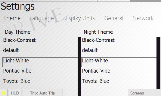

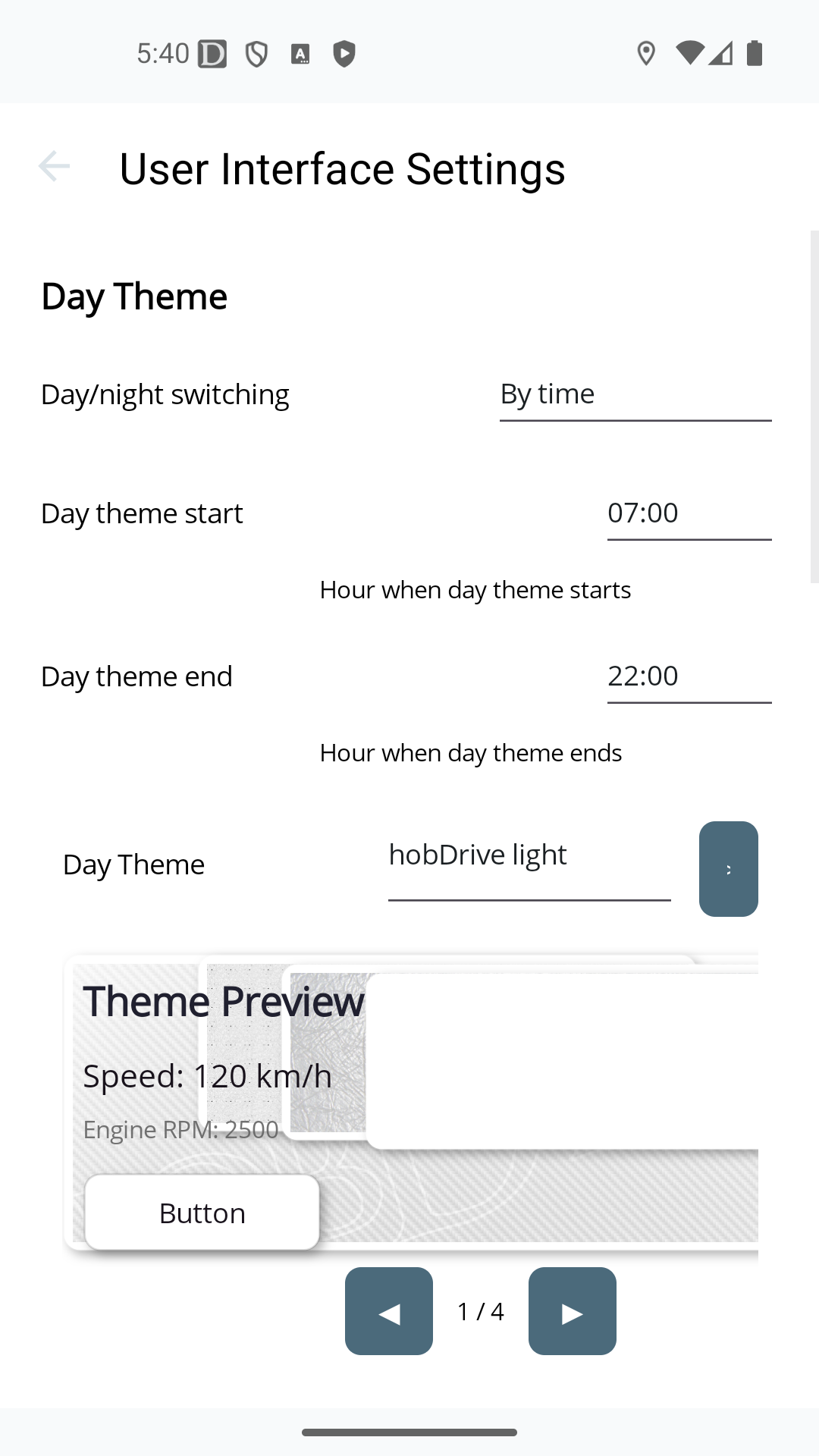

Appearance
Supported options include:

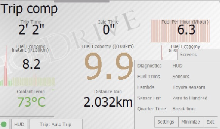

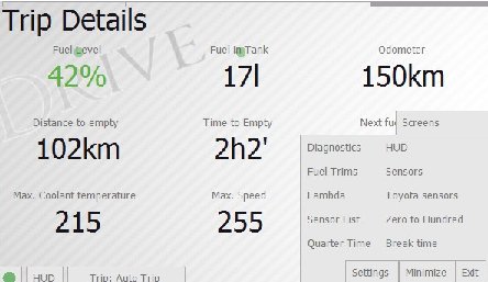

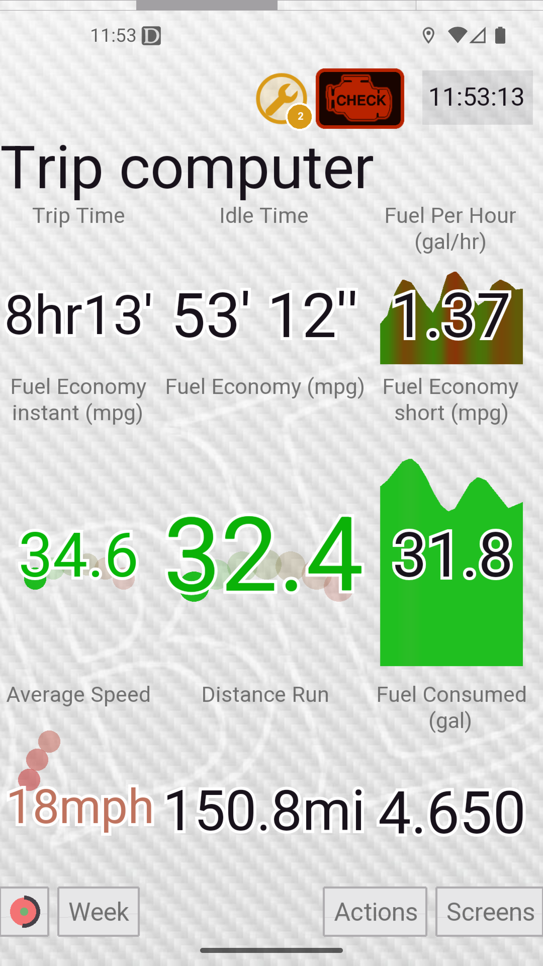

Trip Computer
This screen shows the main values for the current trip or selected time interval, letting you evaluate both overall efficiency and instantaneous consumption values.
Main metrics:

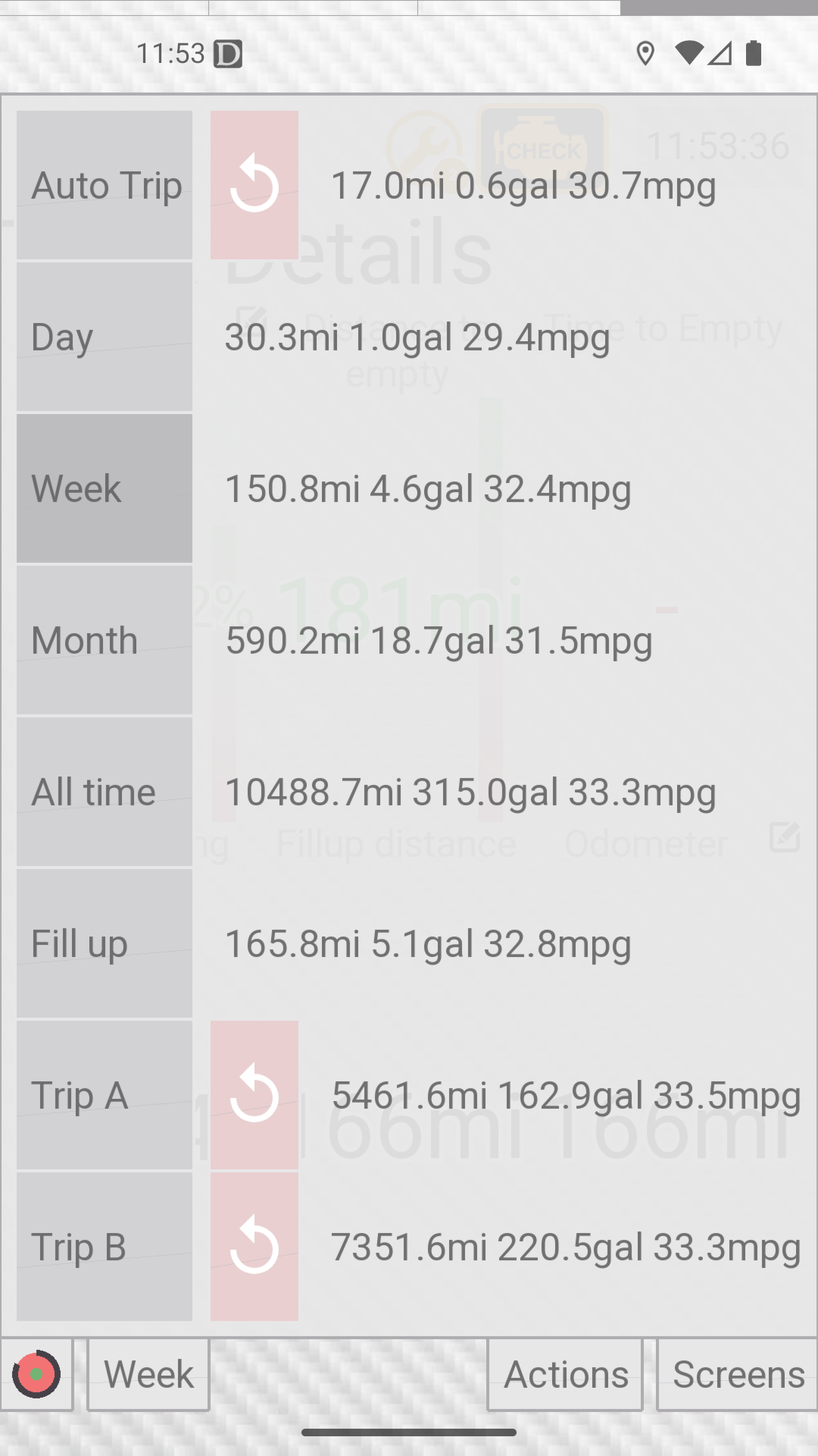

Time interval selection:
Tapping the Trip button shows available tracking intervals. When a new interval is selected, all values update to reflect stored data for that interval.
Manual reset is possible for Auto Trip and Trip A / Trip B modes.

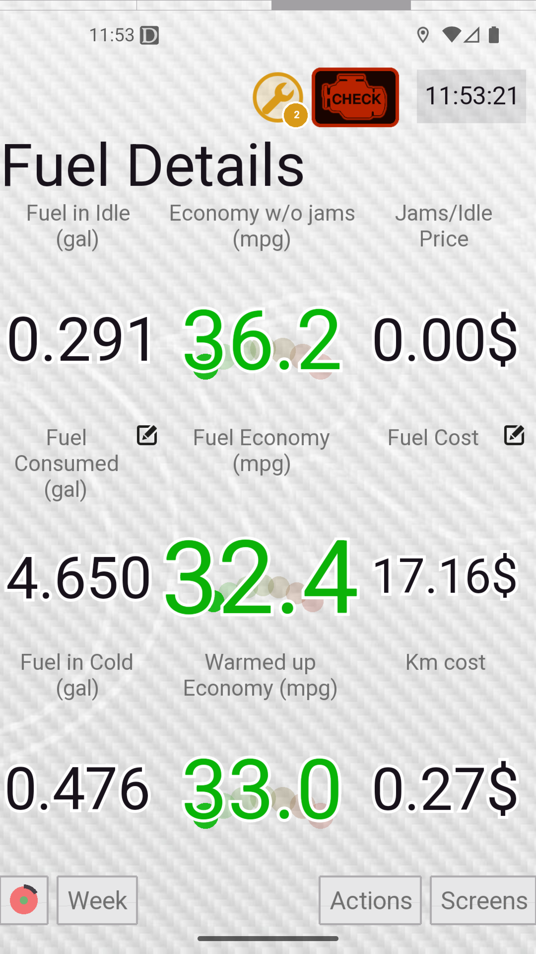

Fuel Consumption Details
This screen provides detailed information about fuel consumption:
Sensors highlighted in green can be fine-tuned for higher accuracy. Tapping the price sensor opens a screen where you can set the current fuel price per liter and currency.

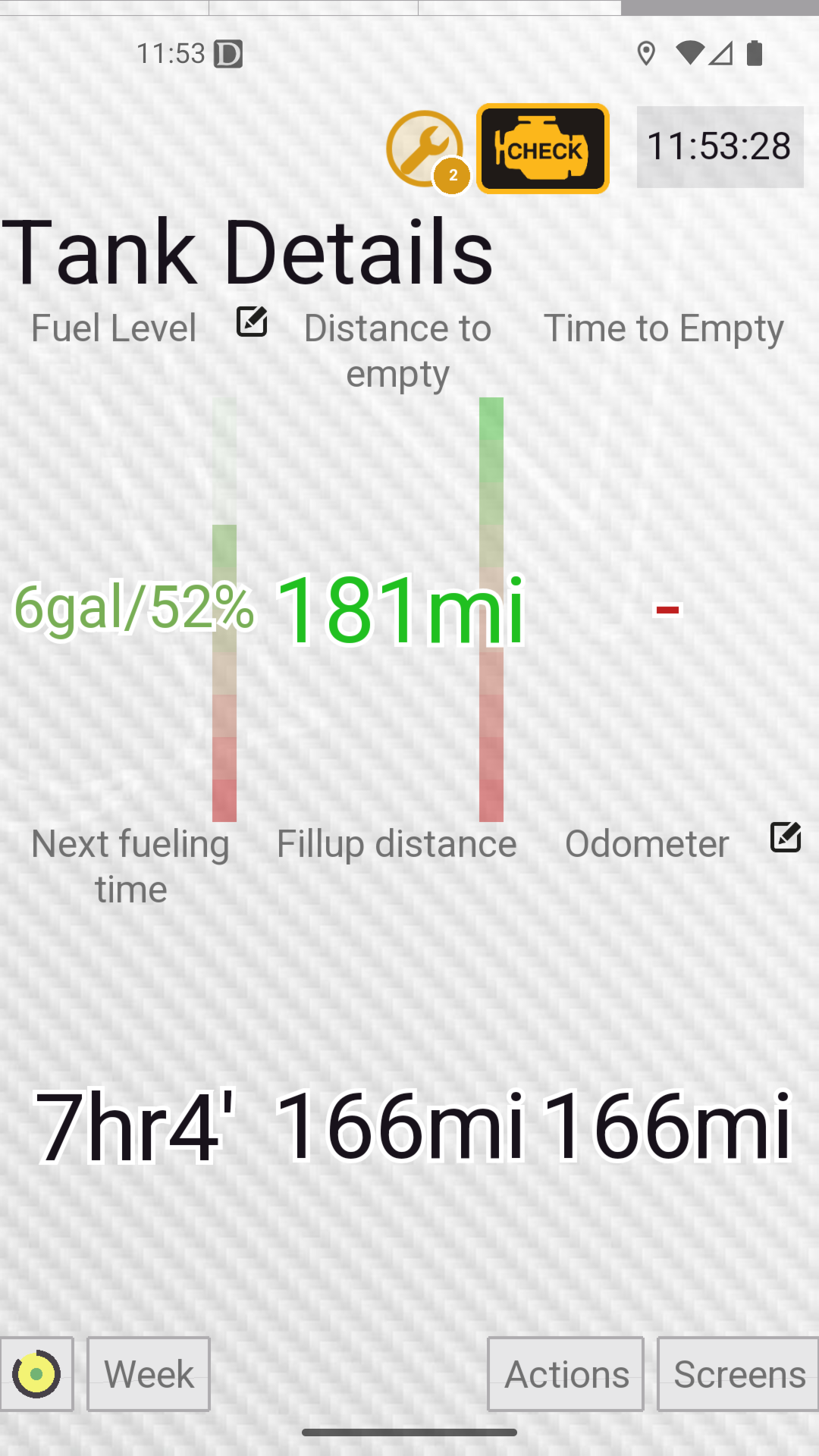

Fuel Details

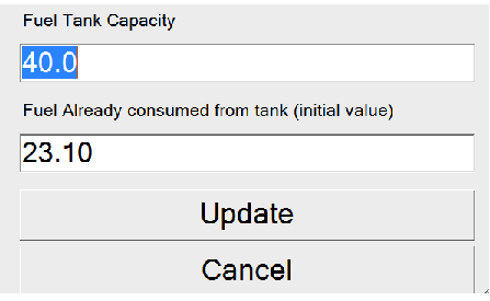

This screen shows detailed information about fuel in the tank and tank calibration.
The current estimated fuel level and estimated fuel volume in the tank are calculated from fueling records and consumption data.
Tapping one of the fuel level sensors opens the tank calibration dialog. On first use you must enter your tank volume and an approximate amount of fuel already consumed.
HobDrive then automatically decreases the estimated fuel amount. To keep it accurate, you need to enter fueling records regularly.
HobDrive does not use the raw ECU sensor value directly. Instead, it shows the calculated value based on entered fuel data and consumption.
Additional values calculated on this screen include:
Some cars transmit the real fuel level from the ECU. In HobDrive this sensor is called ECUFuelLevel. HobDrive displays the calculated value instead, based on entered data and fuel consumption.

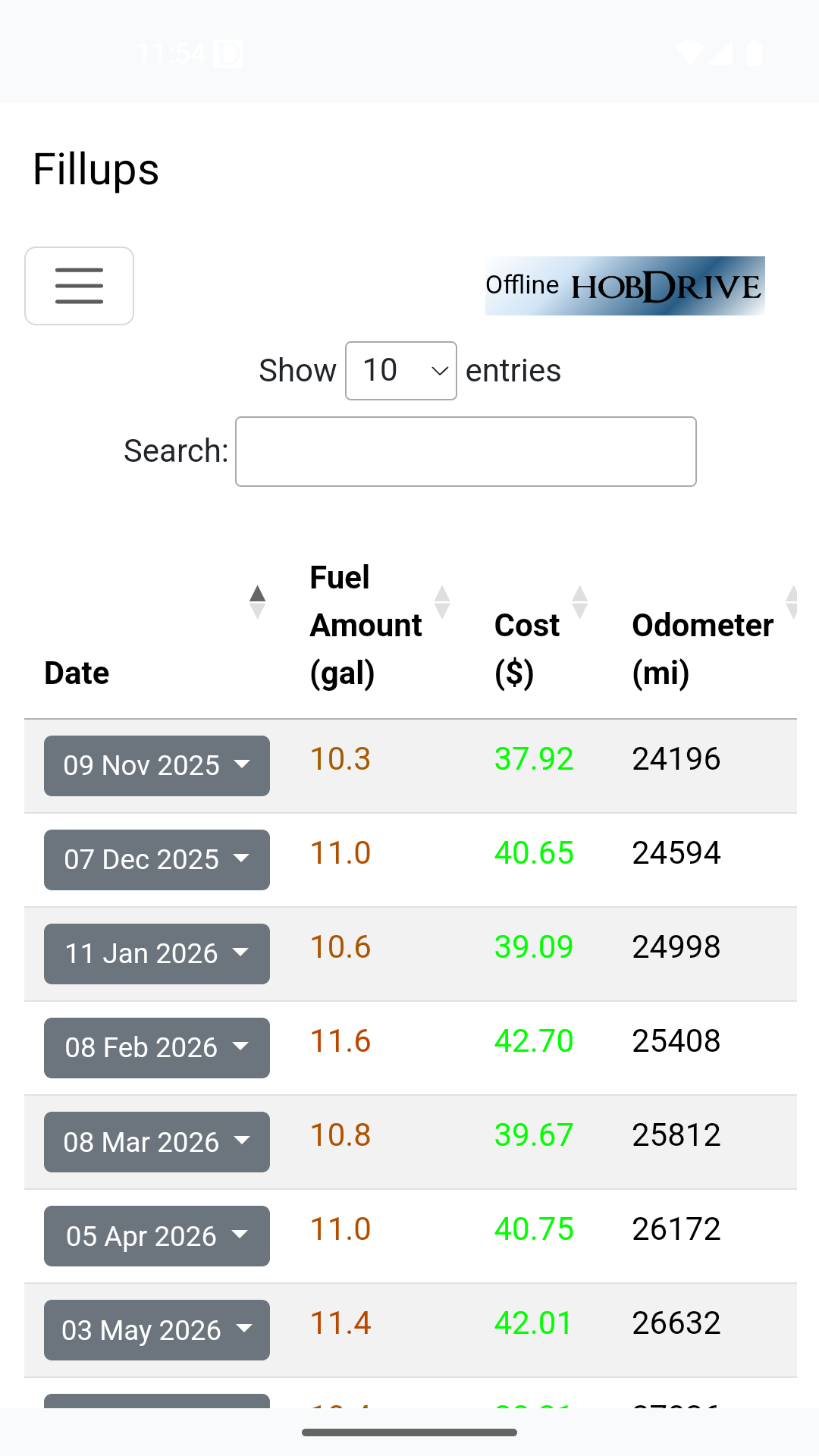

Refueling and Events
This screen is used to analyze refueling and event data saved by HobDrive.
The table contains the following fields:
The last row shows summary totals: total distance, total cost, average consumption.
Sorting, filtering, and record editing are available.
Keeping records:
Data is entered through the Actions panel:
Using refueling records, HobDrive lets you estimate fuel costs, total cost of ownership, and cost per kilometer.

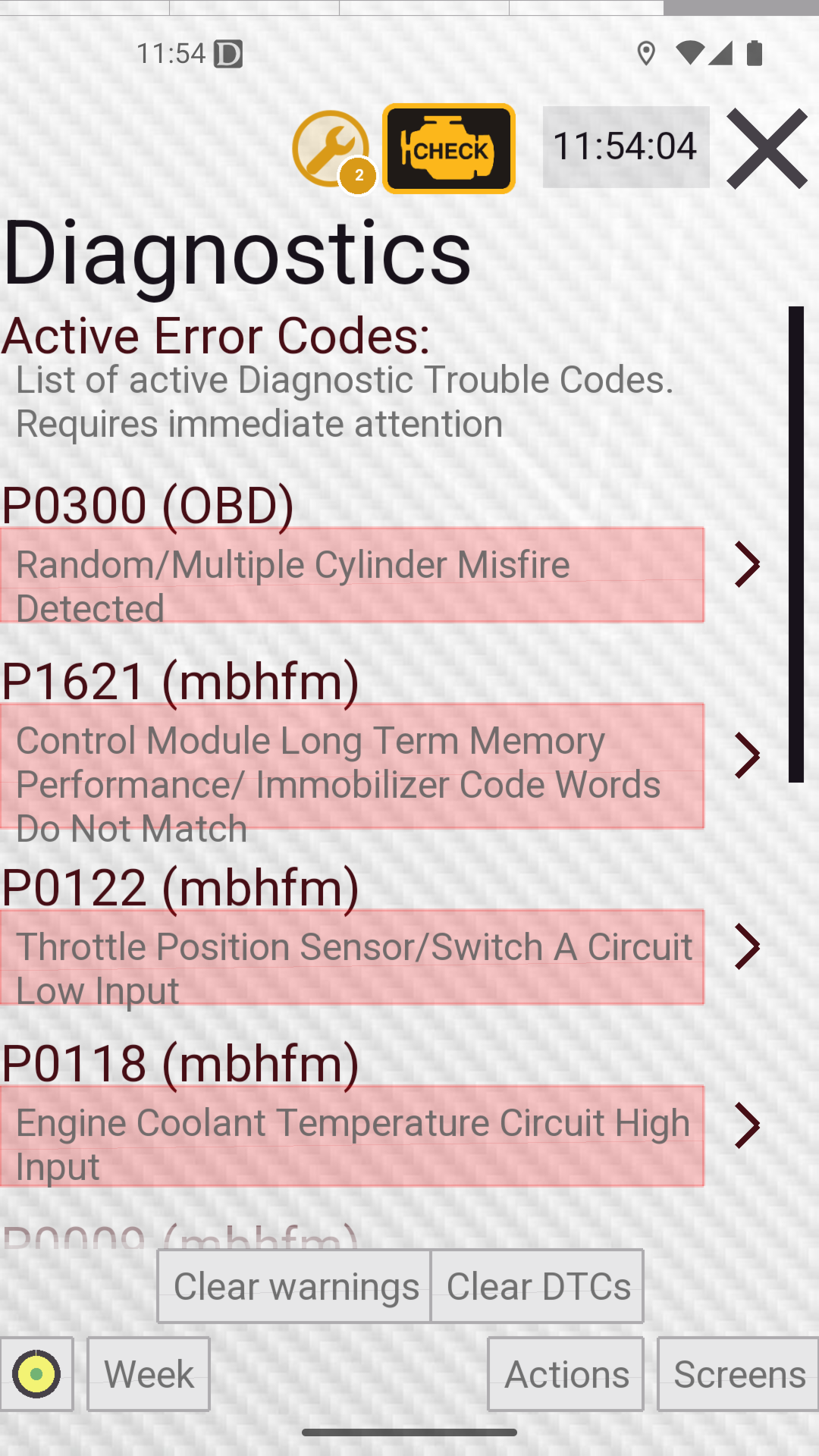

Diagnostics Screen: screen for diagnosing various warnings, engine errors, and their descriptions.
When activated, fault codes are read:
The Clear Errors button allows clearing codes if necessary. Note: clearing does not solve the underlying problem. Freeze-frame codes can be useful for diagnostics at a service center.

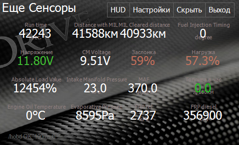

Extra Sensors, Toyota Sensors, Sensor List Screens:
Additional sensors, mostly useful for professional diagnostics.
The sensor list screen lets you select any sensor and start reading its value.

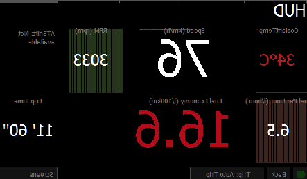

HUD Mode
HUD mode hides unnecessary interface elements and prepares the image for projection onto the windshield. Use it primarily as a supplementary mode that doesn’t distract from driving.
