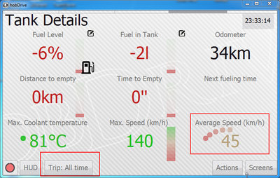

Hi everyone I am new to the forum I call Massimo I'm Italian I have a Volkswagen - Golf IV (1J1) - 1.9 TDI (115 Hp) 6 gear change, I bought the HobDrive application after using the demo version, I'm trying to configure it for My car but I find many problems for example (average speed tells me I do 800, performance consumption tells me that I have 380 hp but it is impossible) can anyone help me configure the program for my car? The sensors parameters to make the program work best thanks

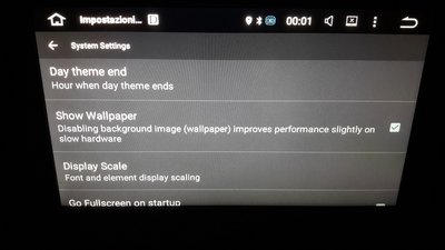

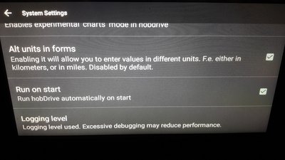

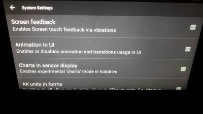

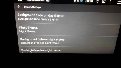

Re: HELP Volkswagen - Golf IV (1J1) - 1.9 TDI (115 Hp)
I made you felle photos with the phone I went in: Screens / settings / system settings /
I can not find the item (debug logs)
Look at the pictures and tell me if I'm wrong, excuse me for my English to use a translator
Massimo.
In the data files, the average speed for the entire program use time is 45 km / h For the last trip 0 km / h For the correct calculation of the flow, you need to use the calculation method "EngineLoad Sensor" (Датчик нагрузки на двигатель (дизель))
More details are described here:http://hobdrive.userecho.com/topics/217-metodyi-rascheta-rashoda-i-ih-kalibrovochnyie-koeffitsientyi/

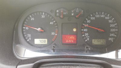

Thanks for the answer, do not you have the ability to make a suitable file for my car? Because even in performance I have erroneous data
- Сообщения: 9
- Зарегистрирован: 03 авг 2017, 20:39
- Имя: Massimo
Hi, I tried to insert what you told me (EngineLoad Sensor) but I do not have any data related to consumption, so in order to detect some data I have to set MAF sensor, I did full of Diesel to see if it was set 100% but when The program tells me that I'm 0% in the car I still have more than half a tank, I also see a difference between the machine's cumputer and the program, the computer tells me it consumes 5 liters per 100 kilograms and your program tells me that we consume 16.5 liters per 100 kilometers
