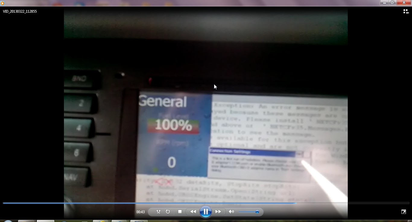

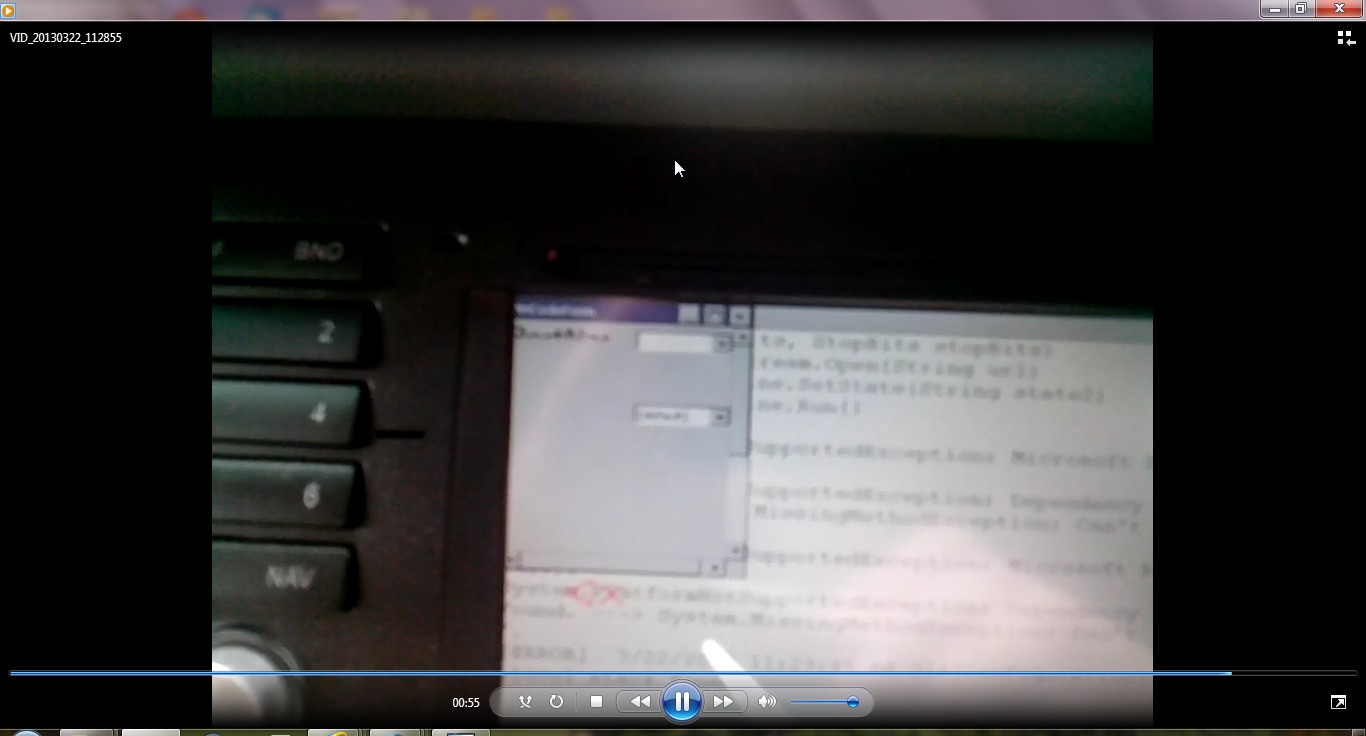

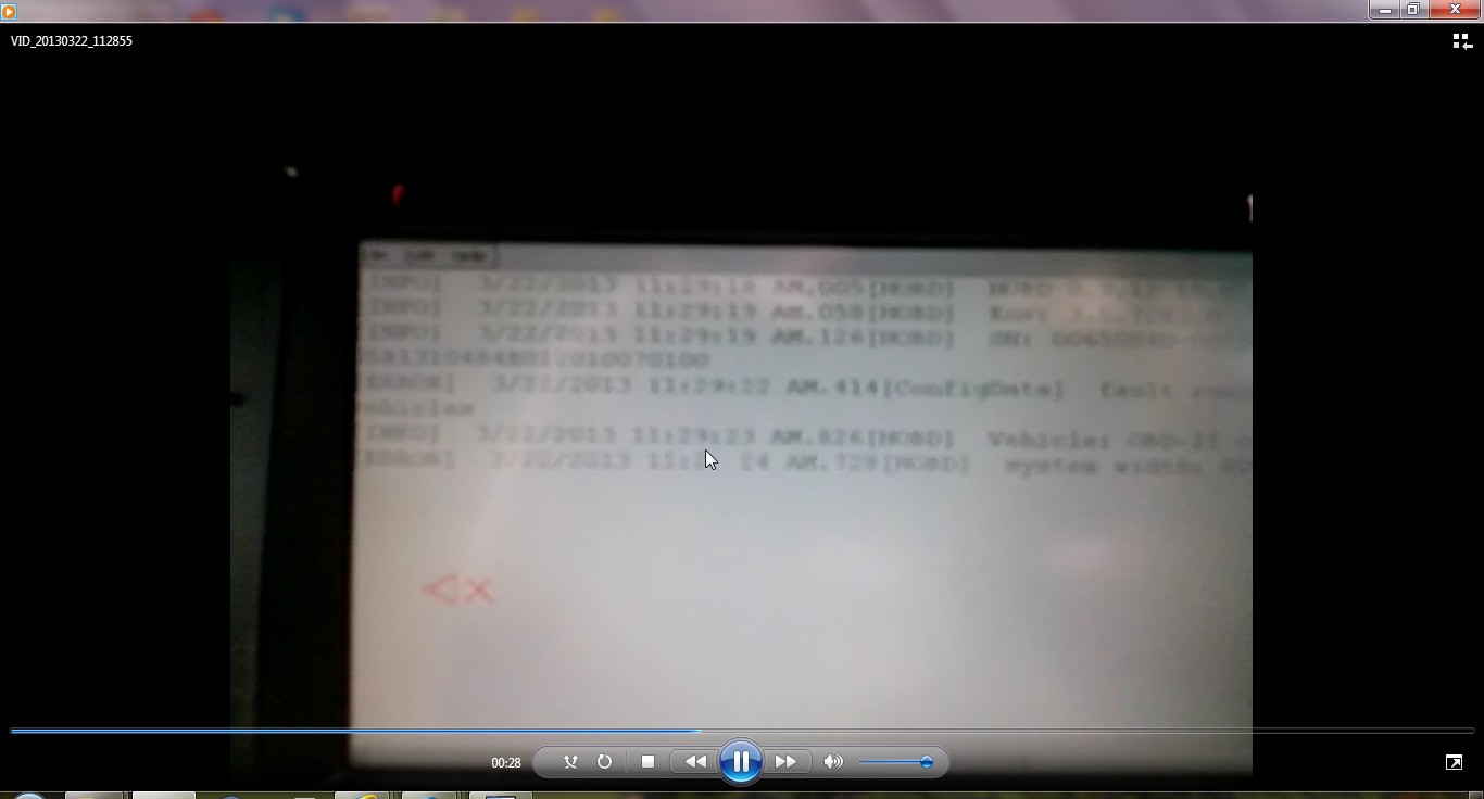

This is the text I get on boot up of the program on my wince5 head unit
pics attached

I see the main screen (partial). Does it appears fullscreen after clicking OK?
Or it remains "small"?

Hi yes it goes to full screen after clicking need to get this resolved as I would like to purchase full system

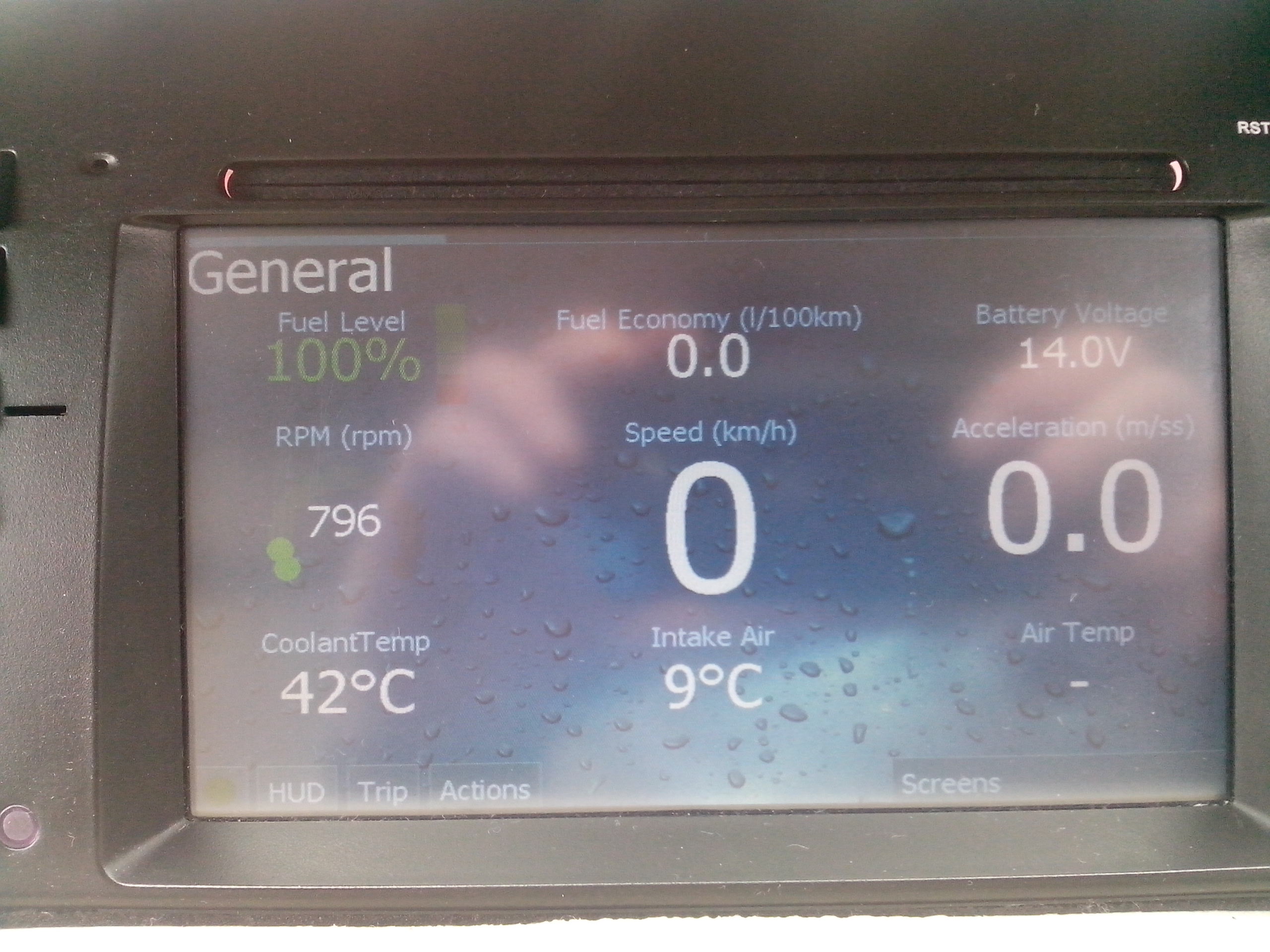

I have the software working ok now but see no data in left hand bottom corner there is a green light but no data whats happening

Stu, what vehicle do you have? You probably should setup protocol correctly.

Hi had trial version working on head unit so I purchased Hoddrive installed on my head unit with same parameters as trial version but cannot get it to work green light is on but no data I also just connect to my laptop with cable and trial software on laptop works perfect ??
Re: Text on screen
Think you have some differences in setup.
Ultimately, just copy files config.xml and user.vehicles from working demo to installation folder of full version. This will inherit all settings and should work.
