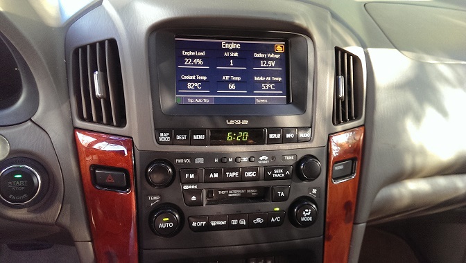

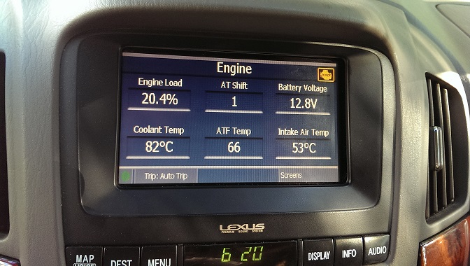

The images above are small example of what I'm talking about:
In the first place, how I tried to improve the looks with my very little knowledge of Photoshop and second, if you notice, the check engine light in the left upper corner. The message says "Low Fuel Efficiency". What the hell?!!
As you see, I don't have any fuel sensor on the screen. This is my only screen. Why the program is showing me that?
And on the other hand, I'm driving 2 kilometers per day, 2 tons, 4x4, 3000cc machine in rush hour in the center of the city, with climate control ON at near 40 degrees Celsius...What fuel efficiency do you what me to have?

2. Is there a way to switch off (to exclude) sensors from the calculations? As you see in the photo
there are no fuel sensors and still it shows "Engine check" sign with "Low Fuel Efficiency Error".

1. Thats a bug, we'll fix in soon. 12/11 is an extra ECU bit, meaning gydrotransformator lock is active.

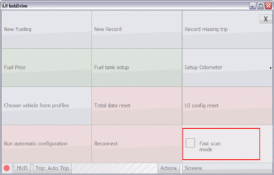

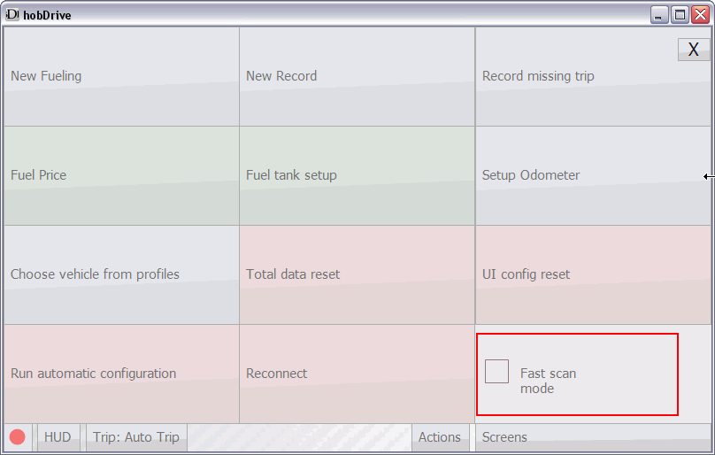

2. You may press "Fast diagnostics mode" - that will force hobdrive to stop MPG background calculations. We however don't have an option to enable this mode on startup. Will add that.

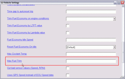

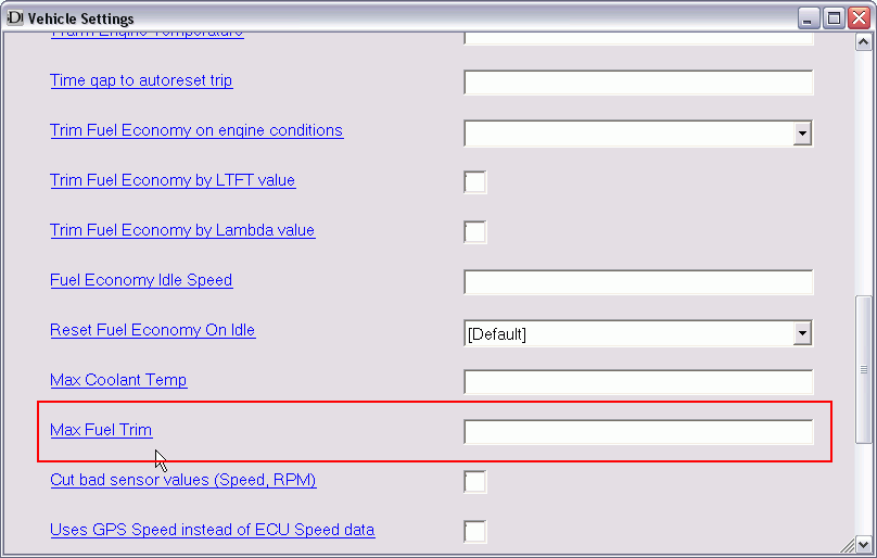

"Low efficiency" warning is an LTFT threshold overlap warning. You may increase the guard value in vehicle settings to get rid of it.

Thanks for the reply. I'll do that but does it mean that for now I have to press the fast mode every time I start the program?
P.S. Sorry but it seems I cannot find these settings: Fast Diagnostic Mode and Low Efficiency threshold. Where they lay?
Low Efficiency
